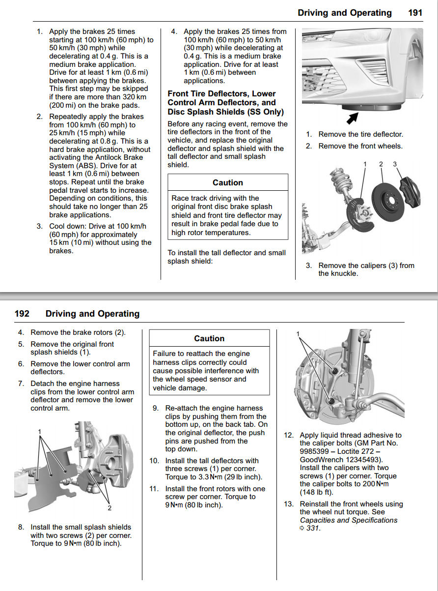

Brake Burnishing
5.) To prepare the Camaro brake systems for
 track events and racing, complete the appropriate
 high performance brake burnishing procedure
 described below. New brake pads must be burnished
 before racing or competitive driving.
These procedures are specific to the Camaro SS,
 or LT with Y4Q Heavy Duty Cooling System that is
 equipped with J55 brakes. This
procedure should not be run on other Camaro models
 as damage may result.
 아래 기술한거 같이 브래이크 길들이기를 해주세요. SS니까 꼭 하세요.
When performed as instructed, this procedure will not
 damage the brakes. During the burnishing procedure,
 the brake pads will smoke and produce an odor.
 The braking force and pedal travel may increase.
After the procedure is complete, the brake pads may
appear white at the rotor contact. Run this procedure
 in a safe manner and in compliance with all local
and state ordinances/laws
regarding motor vehicle operation.
 Run this procedure only on dry pavement.
Racing/Track Brake Burnishing Procedure
Brake pedal fade will occur during this track burnish
 procedure and can cause brake pedal travel and
 force to increase. This could extend stopping distance
 until the brakes are fully burnished.
